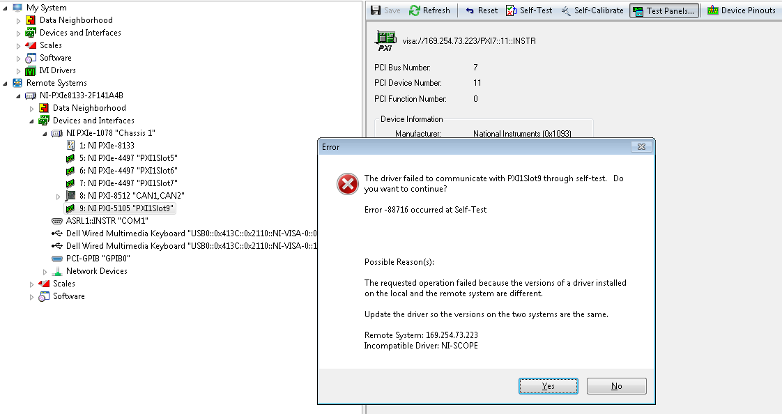

When I attempt to launch the Test Panels in MAX i get the following error:

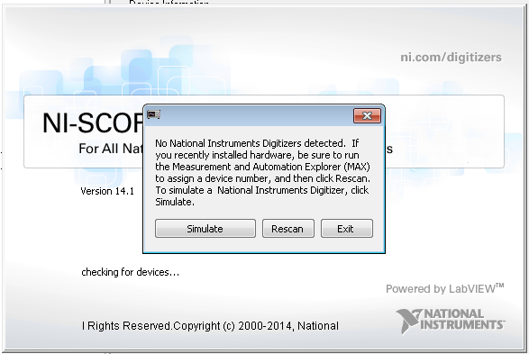

If I attempt to launch NI-Scope SFP, it does not detect the scope card:

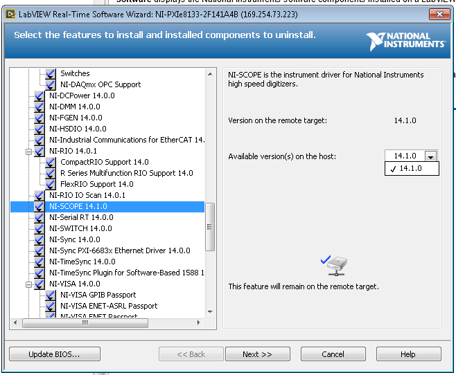

For the RT Target, the NI Scope Installation shows as 14.1.0.
I even checked in the Add/Software feature for the Remote System to see if a driver mismatch in fact was present:
I've also confirmed in the readme that PXI-5105 is supported in NI-SCOPE 14.1.

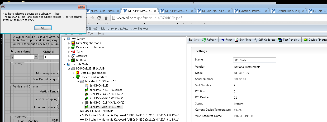

I reverted the NI-Scope Driver back to 14.0 on both the host and RT target.  I know longer get the error about the driver mismatch.
It is showing up in MAX, but I'm still unable to detect it with NI-Scope SFP.
It now shows the following when I try to launch the Test Panels:
This is the first time I am trying to use the card in this system.  The card is currently on loan from another team and had previously been working in their test set-up. The only difference between their set up and ours is they are running windows on their PXI chassis where as we are running Pharlap on the RT target and using a Windows host PC to develop our RT Target application.
The ultimate goal is to run our application in from the Windows host PC using Labview + Real Time Module.
(6,287 Views)
Disregard I have found documentation stating that NI-Scope SFP does not support use of the high speed digitzers via a Labview RT Target:  http://zone.ni.com/reference/en-XX/help/370592Y-01/digitizers/using_ni-scope_in_the_lv_rt_module/
