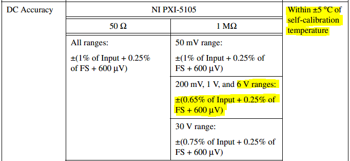

Keep in mind the accuracy of the 5105 device is specified at +/-2mV.

When I looked at the digitized signal of a 5105 in a similar configuration to yours, I saw the same kind of (roughly) +/-2mV noise.  I don't think this is unexpected.  Especially if you leave the front end of your digitizer unterminated, it could be picking up extra ambient noise.

Sorry, to be clear, when I said the accuracy is specified to +/- 2mV, I meant to say I got that result by putting in the value for the full-scale (FS) range setting you have your digitizer configured for (6v) and putting in 0v for the signal term.
