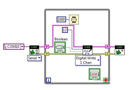

hi,
below is the block diagram of led blink program using linx for arduino.
When i run from the labview the program is working(led is blinking on arduino). But when i create standalone application it is not working.

When you say: ". But when i create standalone application it is not working"
you mean without usb connection to arduino?
if you mean that, in fact it will not work. This does not compile a code to arduino.

yes, i think when using VI from labview the code gets complied and uploaded to arduino. But when creating and using standalone app i think the code does not get uploaded.
So is there a way to get standalone app to work with arduino?
Message 8 of 12
(4,417 Views)
The code is not compiled and uploaded, you will always need a serial connection to communicate the arduino and PC. If you need a headless application, i sugest using raspberry pi.

What do you mean by standalone app?
1.  Do you mean an exe running on a PC connected to an Arduino?  This is possible.
2.  Do you mean you expect the Arduino to do something based on the LabVIEW VI without be being connected to a PC running a LabVIEW application?  This is not possible.  This is referred to as headless, no PC is connected to the Arduino.
