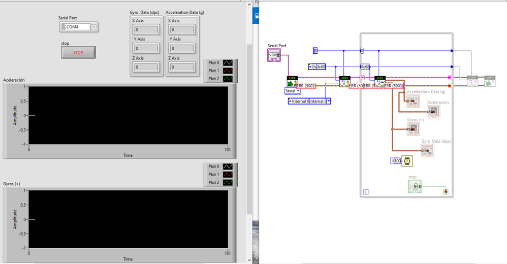

I hope you are well, for my part a little distressed, I have not been able to obtain the data from a gMPU 6050 Sketch.pngyroscope MPU 6050, although in Arduino I can read it,  in Labview 2020 with LINX, it has been impossible for me to get out of error 5003 that followed his advice to increase the waiting time, following the sequence ...
Open Serial -> Initialize -> Initialize Device -> Synchronize -> Send Command -> Wait for Packet-> Wait for bytes with a delay of 2000ms, over the original 100ms, but nothing, also on the Arduino side I have LIFA loaded .ino ... but nothing, I would appreciate new ideas ... I almost forgot, the blink example if I can make it work according to your advice.
Since already very grateful for your cooperation. and an apology for my poor English.
