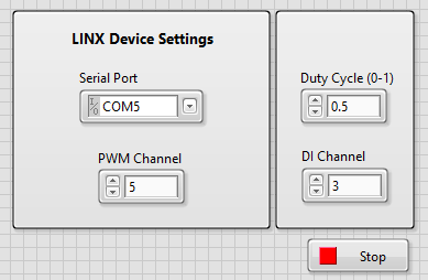

My hardware configuration:
Block diagram:

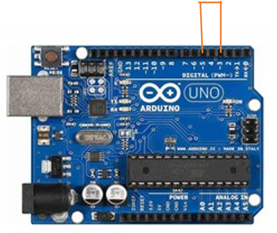

My Arduino connection:

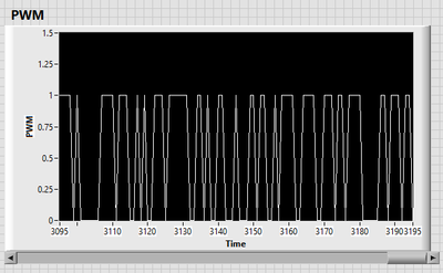

My signals
Obviously, you can see that these signals are not square waves and my PWM = 50% or 0.5.
How do I fix this?

You're not sampling fast enough, as per the Nyquist theorem, you need to sample at least twice faster as the maximum frequency of interest.
More over, you're sampling one sample for every duty-cycle which is not even a waveform.

Few inputs,
  1. Do not update the PWM duty cycle for every iteration of the while loop, do it only when you change the duty cycle
  2. Read Digital input at regular intervals and not as fast as possible
  3. You cannot separate them into two loops as both talk to the same Arduino and Arduino can do only one thing at a time.
These should give you better looking representation of the PWM Generated but not the realistic one as Arduino's are not DAQ devices to sample at a high rate and stream with reliable timing accuracy to the PC.
