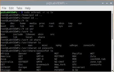

@Choke Looking at your Labview.png I can see that the timezone on the LabVIEW chroot is not set to the timezone you want.  If you have this set properly the date command would return the timezone you want.  This is the first thing to figure out.
You have stated that you did what I have outlined above but what is not clear here is if you did this all in the LabVIEW chroot.  If you did this in the LabVIEW chroot then something was not done properly.
Here is what it looks like in the directory if you have the timezone installed properly.
Here is what is looks like if you have a localtime setup to a timezone file properly.  Note that localtime is not a directory as it is a file.  I have accidentally copied over a directory to this location before and if you do this the timezone will not properly be displayed.  The timezone file is not a text file so if you use cat to display it the text will be unreadable.
I would review this as this is what you need to get the date command to return the proper timezone.  Once you get this to work you can then move on to step 3 to get LabVIEW time to use the timezone.
Once you get the configuration of the LabVIEW chroot done properly you can use the code here to experiment with changing the different timezones on the RPi, https://github.com/wiltdavi/Simple-Pi-WebVI-WebSockets.  Note: This code requires the Chroot SSH trick and Run ‘sudo’ Command Without Entering a Password in Linux to be configured on the RPi for all the functionality to work properly.
