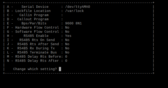

I am using LabVIEW on Raspberry Pi to retrieve data from Modbus enabled devices.
The devices that we need to communicate are TCP and RTU based devices.
By using Modbus pallet from LabVIEW I managed to get data from TCP devices.
However, when I try to interface on RTU device, I am running to errors. I have installed physical RS-485 converter on Raspberry Pi.
And the device is working as I have verified using python script. The detail of the device is as follow.
when I run the following code, I received the VISA resource name "ASRL1::INSTR".
But when I run this code, the error is returned, seems like the one I am using is not /dev/ttyAMA0.
Can someone help me on this, how can I bind this device path /dev/ttyAMA0 to LabVEIW VISA resource name?

Hi Tark and Jorge,
Thank you for your suggestion. I have tested and can confirm both of your statements that enabling the serial console won't work when you are using UART.
The issue we had was slightly different, one of our engineers read the information from the supplier website (https://www.abelectronics.co.uk/kb/article/1035/raspberry-pi-3-serial-port-usage) and he was confused between mini UART and PL011 UART. Thus, he basically followed the steps to disable the PL011 UART.
Then, this issue arose and when we checked with supplier, they recommended to install additional software called minicom to set the configuration. All these combinations might caused us not being able to retrieve data using LabVIEW.
Now, we managed to solve the issue by simply reinstalling OS and started from the scratch.
