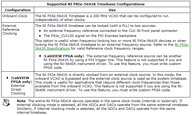

Recently we have met with an issue when using external sampling clock on 5641R. When we use  5641R Internal,everything is O.K. Signal we get is stable. But when we use External Clock (The “Clock In “ is connected to the Sine signal generated by Pxie5652,10dBm). Abnormal phenomena: The amplitude is not stable within the acquisition time. Settings: Ni 5640R configure Timebase.vi: CDC Clock Source=SMB External Ni 5640R ADC Configue NCO.vi: Previously Configured Clock Frequency= Sine signal generated by Pxie5652.

1) You have mentioned that you are using NI 5640R Configure Timebase.VI, Using this the clock that you bring in can only be used to PLL (Reference Clock). In order to use the CLK IN as an external sample clock, you will have to program in LabVIEW FPGA, based on the help documentation below:
