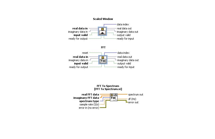

I am using PCI-5640R  and PXI-5600. I want to use "Scaled Window" and "FFT" exspress VIs of "FPGA Math & Analysis" Functions Pallete in my "FPGA VI" and "FFT to Spectrum" VI  of "FPGA Interface" in my "Host VI".
Can any one post some example code in which these three subVIs are used.

Hi Rashid,
There are two shipping examples here: LabVIEW 2009\examples\R Series\FPGA Fundamentals\Analysis and Control\FFT\
