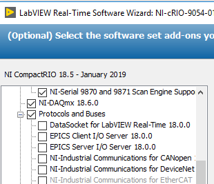

I think you may have just overlooked installing the correct driver! I noticed that your cRIO did not have NI-Industrial Communications for CANopen installed, and that you were opening up a CAN example (installed with our CAN and XNET drivers, not the CANopen driver). Our CANopen examples have CANopen in the name, such as NI CANopen for cRIO.
Make sure you've installed the compatible CANopen driver to both your PC, and then also install it on your cRIO as well (it shows up on the Software Wizard under Protocols and Buses). I put a screenshot below (I have newer software, but it should look similar).
Here's a nice page to see the compatibility of the driver versions with your version of LabVIEW, and a link for accessing all of the different download versions. If you're only working in LabVIEW 2015 SP1 or newer, you can go get the newest NI Industrial Communications for CANOpen driver. If you're still working in some older versions of LabVIEW, you can grab an older version.
