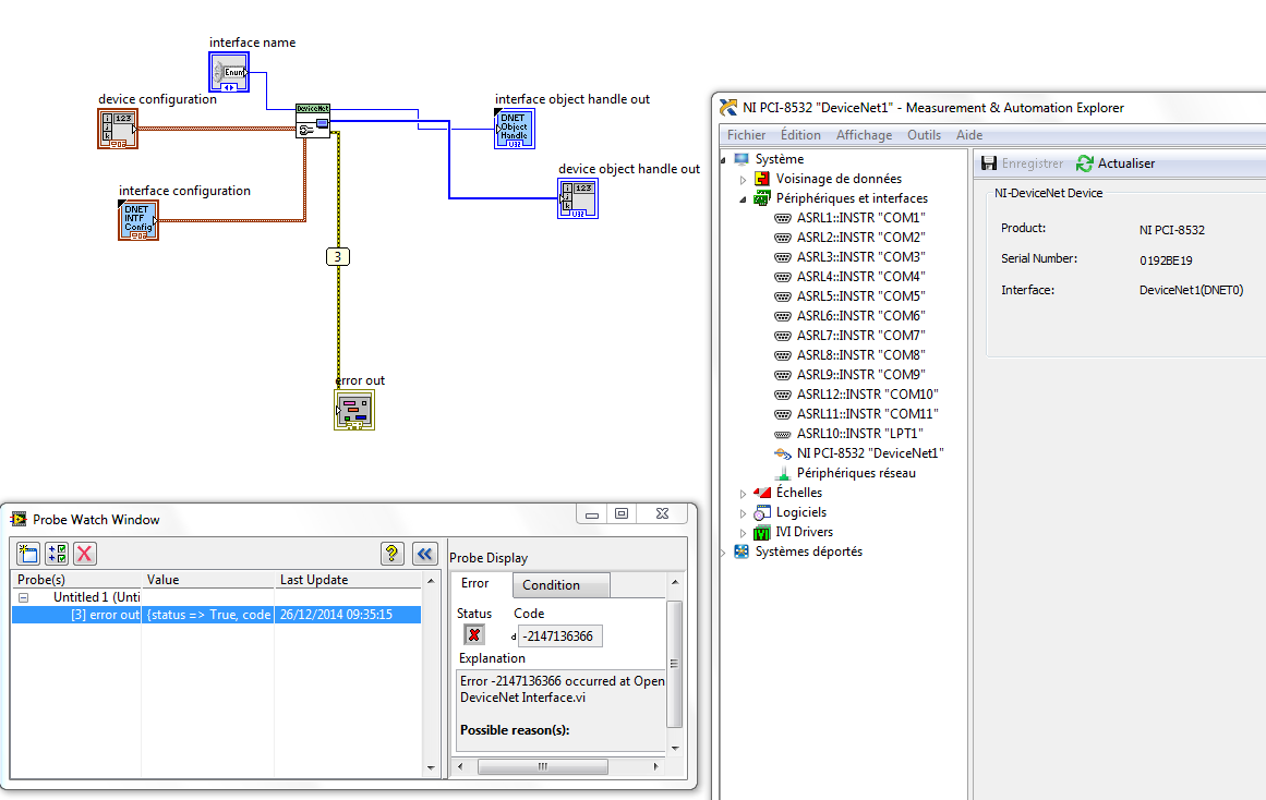

I am new in the use of NI PCI8532 DeviceNet card, i just tried to test it with an example of devicenet palette (Easy IO Config),
but the program show this msg and i don't how to config it because in IN Max idon't have enough information.
So, how can I do?
i need to know how config the I/O and the interface configuration of the NI PCI 8532 devicenet card?Capture.PNG
Many thanks.

Hi Firas.Lachhab,
Please create a new topic for this question.  I will be able to better help you from that topic, as these topics are not related.
You will not configure anything in MAX with the NI DeviceNet cards (as opposed to the earlier DNET cards).  I would suggest taking a look at some of the examples for DeviceNet.  These are located in Help » Find Examples » Hardware Input & Output » Industrial Communications » DeviceNet » PXI & PCI » Basic.  This should show you how to set the card up as a master or a slave.
Thanks!
Matt S.
Industrial Communications Product Support Engineer
