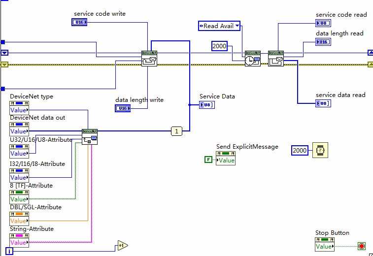

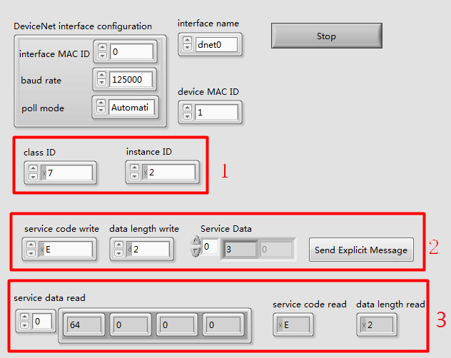

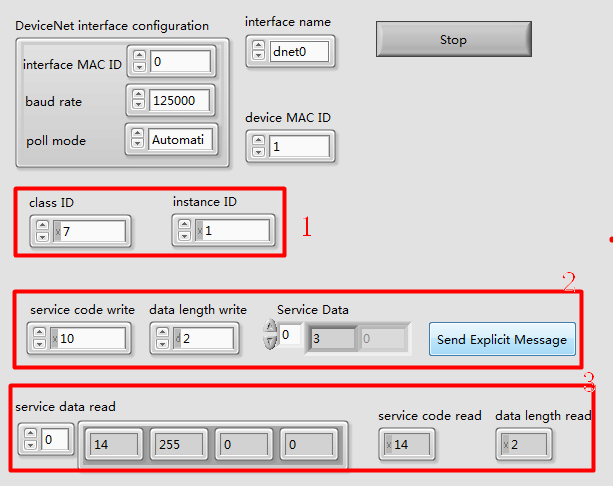

use explicit message , service code with 0x0E and 0x10, results is follow picture.
