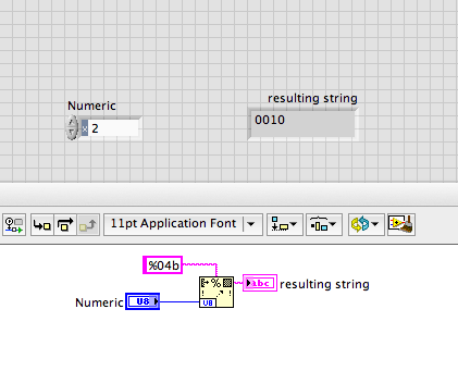

So you want to transmit ASCII "1" "0" "0" "0" for a 1?
I would start with a numeric control, not a string control. Use U8 representation. Set display format to to Hex and data entry to limit values to 0..15. Then use Format into String with "%04b" as the format string.  Connect the output to the input of the VISA Write.
Note that this produces the reverse bit order from your example.

taking Lynn's approach to the end.

Jeff - I could not obtain the result you did when I implemented your picture into a VI.
It took me a little while to find the Sort 1D-Array function(?) For the sample in your post, I am getting 0001 for '2'.
Must be something I am not configuring right in that function or elsewhere...
I think that's the Reverse 1D Array
(8,458 Views)
@crossrulz wrote:
Yes that is reverse array not sort array.
That thing there is actually a "code snipette." Drag or copy it to your desktop then drag it onto an empty LabVIEW Block Diagram.  Identical code will be generatedSmiley Wink
Yeah, its really coolSmiley Wink

Worked fine once I replaced the sort array with reverse array!!
