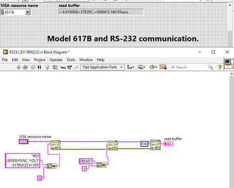

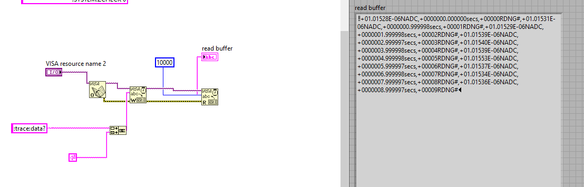

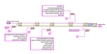

I got a 6517b for RS232 example (RS232_6517BtracedataRS232_example 1.vi, attached), but the timeout expired error appeared at VISA Read. Before reading the data, the 6517B works well. (e.g., voltage set 1.0V, changed the mode as current measurement, and others).
Here are the error code and diagram for mine
Possible reason(s): VISA: (Hex 0xBFFF0015) Timeout expired before operation completed.
I also got another example of 6517B for RS232 (RS232_6517BRS232_example 2.vi, attached). it indicated the same error as above.

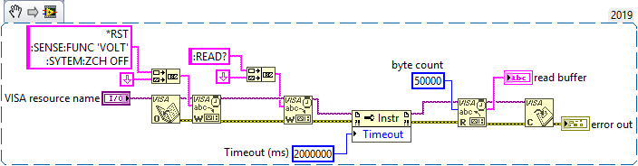

You could just set a longer timeout and wait.  But read this to better understand synchronizing instrument requests.. https://www.ni.com/en/support/documentation/supplemental/06/using-instrument-status-registers-and-se...

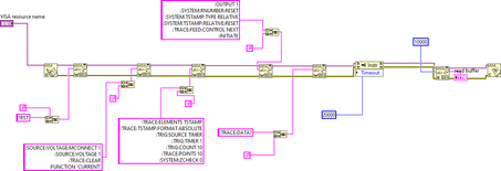

I mimicked your vi with "VISA Set Timeout" function.
However, the timeout expired error appeared without reading the buffer after the time, what I set as the timeout as 20,000 (in your example 2,000,000).
The measurements had been done before the timeout (20,000). I set to measure the point per every second for 10 secs, but ":TRACE:DATA?" didn't read the buffer from the equipment.
I think the problem is ":READ?" and ":TRACE:DATA?" these parts. the instruments didn't get back the data.
for the example 1 case (:TRACE:DATA?), it couldn't read from the buffer. it just indicated "" on reading buffer part.

In your code you need to set the timeout before you send the :INIT; command.  That command starts the measurement and the wait is only 1000ms, but then you immediately ask for data which will cause the timeout.
In your original code you used a Line Feed, now you are using a CR as termination. Are you 100% certain you need either?  VISA should handle that for you.  You might be appending a second termination character.
