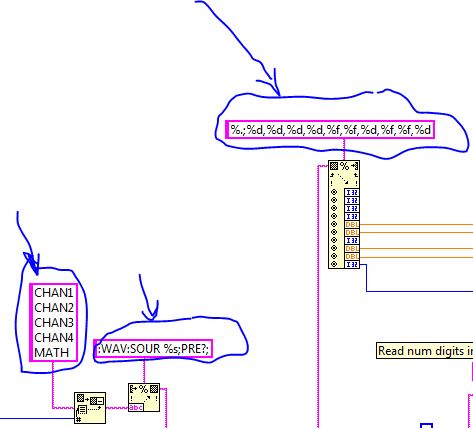

you are right ,but to correct this problem i have to understand the driver ,
I'am sorry i thinked that write buffer is a command to  call function (in .DLL files)  🙂

You probably need to take the LabVIEW fundamentals classes or at the very least, some of the free tutorials. You should also have context help open. Format Into String and Scan from String are pretty fundamental.
While it's nice for you to look at the block diagram, is there an actual problem where you are getting an error?

The commands you do not understand are instrument commands, not LabVIEW. They parts of a string being sent to the oscilloscope. Consult the manual for the instrument to understand what they do.
