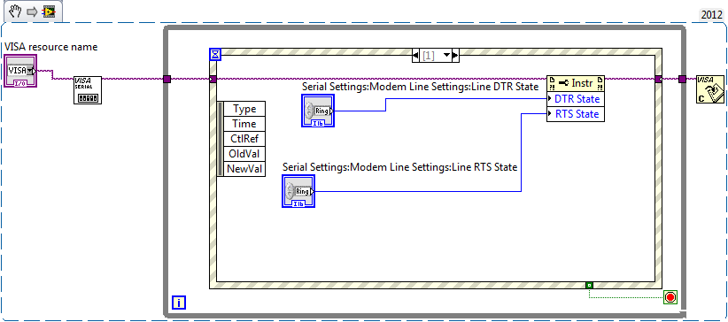

here is a small test vi
Now take a DMM and check the voltage levels on the DTR and RTS line of you COM port
Should be 9 pole male sub D , take care not to shortcut some pins!!
measure between pin 5 (GND) and pin 4 (DTR)  or 5 & 7 (RTS)
To ligth a LED I would start with a low current LED and a 10K resistor.   If you have the LED running 😉  replace it with an optocoupler  and a resistor to limit your current below 5mA. (Say (12V_level-1.8V_led)/5mA  -> ~ 2.2k Ohm

Henrik,
More than very much thankful. Using it already ,just the unknown case causes labview error so i deleted the unknown case.
Thanks a lot 🙂
