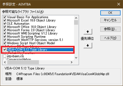

1. Reference Library
Added the following libraries (x.x depends on the version of VISA installed.)
  • VISA-COM x.x Type Library
