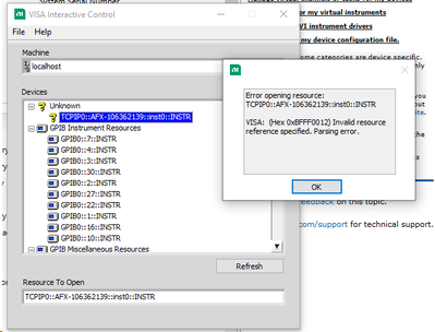

I am trying to initialize Pacific Power AC Source using NI VISA, communication is TCP using USB to computer, if USB is disturbed Then I loose connection with Power Supply, I create a new session every time during initialization
Session session = (MessageBasedSession)resourceManager.Open(resourceName);
// session.Add(resourceName, (MessageBasedSession)session);
return (MessageBasedSession)session;
But I end up getting Parsing error as below -
Please can someone suggest a idea or thoughts to resolve.

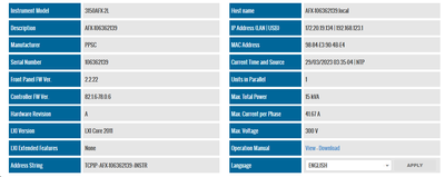

I use Virtual LAN but USB 2.0 A to B Cable.
I have had no problem in initializing, also as shown when connected to web page of device, Address string is embedded, can't change.

Yes, I had tried using TCPIP0::X.X.X.X::inst0::INSTR, but I get same error when interrupted, Does this string should end in "\r" or "\n"? Any other suggestions?
