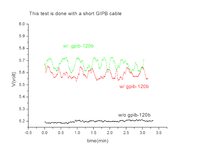

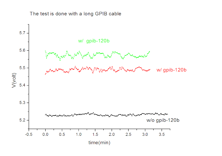

We recently attempted to install GPIB-120B between the equipments and the computer.
But GPIB-120B seems to cause severe noises on our measurement.
To be concise, we measured an amplified DC voltage of a field effect transistor.
At the amplification stage, voltage preamplifier and lock-in amplifier were used.
With GPIB-120B installed, the voltage oscillations are much larger.
The noises are more severe with a longer distance between the computer and the multimeter.
 For the long distance, the length of GPIB cable is about 5m, and about 2m for the shorter one.
The test results are shown as the follwoing images.
I can't think of any reason that causes this problem, can anybody help me?
Thanks alot
 Short distance
long distance
Message 1 of 13

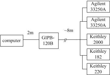

Hi. Steven.
I further checked the setup in detail and drew a schematic configuration for those equipments that are controlled via GPIB. The data shown previously was recorded by Keithley 2000 multimeter.
1.Power
The computer and those equipments are powered by two separate UPS(Uninterrupted Power Supply). The two UPS are then connected to wall plugs. I think everything is grounded through 3-prong plugs.
2.Cables
As for the GPIB cables, they are shielded. The part number is E119932.
3.Length
If I shorten the length between GPIB-120B and the instruments to 2m, the noises become severe as mentioned previously.
I also tried to power GPIB-120B through the two UPS and directly through the wall plug, but no satisfactory result was reached. I’m not sure whether Keithley 182 will have the same problem. It may be checked later on.
 Configuration

Arthur and Albert,
Albert's point of view is something that I have not considered before.  Since the grounds are isolated at the GPIB-120B, you are arguing that its like having an antenna connected to the ground of the instrument.  If Arthur were to take measurements using the front panel with a GPIB cable connected to nothing (except the instrument), would you expect to see the same results?
I believe that this would show that the problem has to do with grounding and not necessarily the GPIB-120B.
Let me know what you think.
I will see if we are able to reproduce this issue here.
Steven T.
