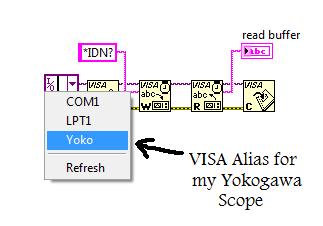

Hmmm. This is an interesting one. I have just grabbed myself a GPIB-USB-HS device, plugged it into my desktop and placed down a VISA open, and sure enough, I get immediate access to my GPIB resources.
As a quick and easy suggestion, please can you ensure that resource filtering set appropriately. You can do this by right clicking on the VISA control/constant and select VISA class >> IO session. I am running LV 2009, so I cant garrentee that the setting will be in the same location in 8.2. But it will be in the menu somewhere!!
In he above image the filtering was set to "Instr" (ie. all instruments.) If I select "GPIB Instr" filtering instead, then my options are reduced.
Please ensure that you have appropriate filtering enabled.
