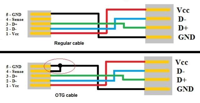

Strip back a spare USB cable and check for voltage after your problem manifests itself
