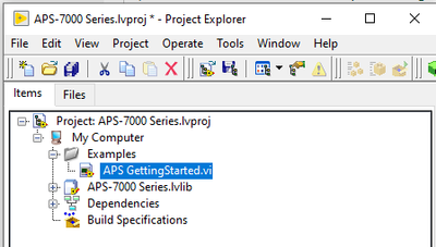

I was able to find a shipping example.
VI Tree present in the LVProj
(downloaded the driver from https://www.gwinstek.com/en-global/products/downloadSeriesDownNew/14888/562)

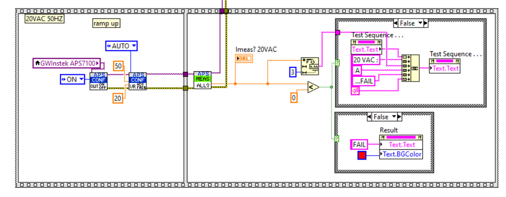

In any case, please refer the below image for a simple program,
Please note, I am associated with neither NI nor GW and I provide this code as per my understanding, it is expected that you take this code as a reference and debug with your hardware.

Hi Santosh,
Thanks for the example, now I able to control and do the measurement.
