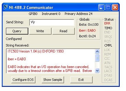

I have been having issues trying to communicate with my Oxford ITC503 temperature controller using the GPIB connection. The device connects and is detected with MAX, but when I try to communicate with it I keep recieving a timeout error upon reading from the device. Writing to it gives no issues and I have been able to set the set point temperature and change the loc/rem state of the device. What is interesting is the when I use the communication tool that comes with MAX, the connection times out but I still recieve a response from the device as can been seen in the image below:

A timeout with some data read could indicate that the instrument is not asserting EOI. Older and some newer instruments are not compliant with IEEE-488.2 that requires EOI. If the instrument does not use EOI but instead a terminater such as a carriage return or line feed, you would need to modify the GPIB properties. The manual needs to be referred to.

I checked the documentation and the ITC503 doesn't assert the EOI line ever and so I think that might be the cause of the timeout. However I have changed all the settings for the GPIB card with regard to terminators and I have had no luck at fixing the problem. Any other ideas?

You may be able to determine the length of the expected output from the device and have the code auto time out the code after the correct amount of data has been received.  What version of LabVIEW and NI-VISA drivers are you using to control the GPIB bus?
