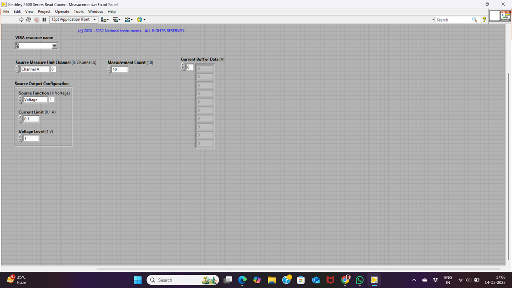

I am using Keithely2612B i try to measure piezoelectric voltage without any external source, voltage vs time sine wave any possible to measure if possible means can i vi of this instrument and i attached my vi of my i1.png2.pngnstrument
Message 8 of 12
(971 Views)
This really doesn't track the solution from the above thread.  You may wish to post this as a new issue rather than a continuation.
If you are trying to read the piezoelectric voltage, then you need to set Source Output Configuration cluster to source current for the Source Function.  Otherwise, you will simply read the 1V input setting for the Voltage Level.
The plan would be to drive 0A and read/measure the voltage from the piezoelectric sensor.

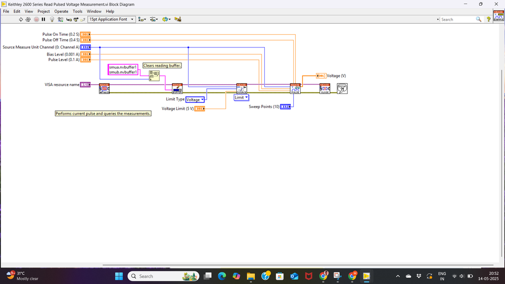

"Is it possible to fix the missing icon issue in the Keithley 6430 VI, and can a similar VI be created for the Keithley 2612B with equivalent functionality for measuring voltage, current, and resistance in my piezoelectric experiments?" and i attached the vi can you please change this one thank you
