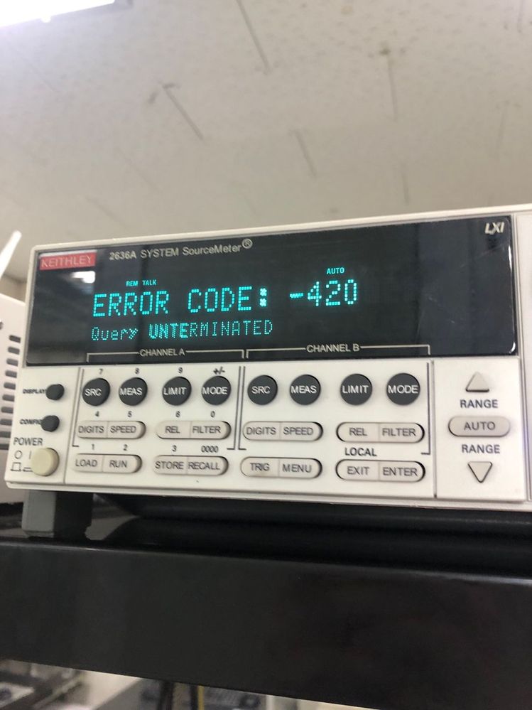

Hello Guys, i am the beginner to use KEITHLEY 2636A. At first i want to test our instrument. I connected a 10 KOhm resistor to KEITHLEY source and i want to conduct device under test (DUT). i write the below mentioned code in python to communicate between PC and KEITHLEY. But, when I run the python(pyvisa) code the KEITHLEY 2636A screen shows some ERROR CODE -420 (Query UNTERMINATED). what is this error means and how we can resolve this error? Your experience and guideance will be appreceated. thanks
Even it shows me result a the end, but still i saw ERROR CODE -420 (Query UNTERMINATED) on the KEITHLEY screen during the measurements.

Have you single stepped the program and if so is this the line generating the error?
current_values[i] = float(keithley.query("smua.measure.i()"))
If so i think you need to put in the query: "print(smua.measure.i())"
The query is doing a visa write and then a read but you have not asked the instrument to return anything there needs the "print".
