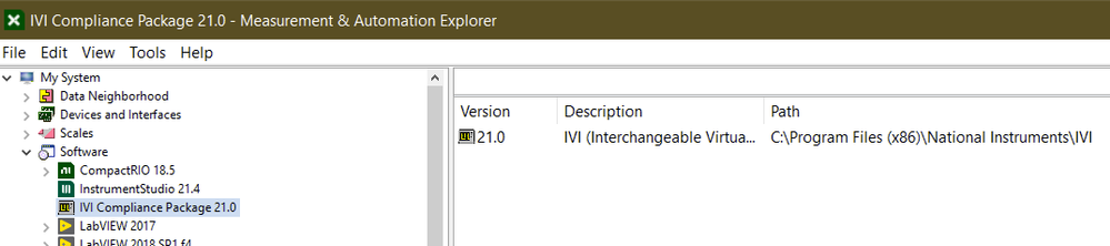

Suggest the following before installing  the drivers for the DAQ970a from here:
https://www.keysight.com/in/en/lib/software-detail/driver/daq970-data-acquisition-system-ivi-driver-...
Insure that .NET 3.5 is ON in Windows 10 under "Turn Windows Features ON/OFF":
Insure your IVI Compliance Package is up to date  in NI MAX
Keysight DAQ970A should be auto detected in NI MAX under Network Devices "Auto Detect". No need to do a raw socket with a port number. VISA session should look like this TCPIP0::192.168.200.13::inst0::INSTR
