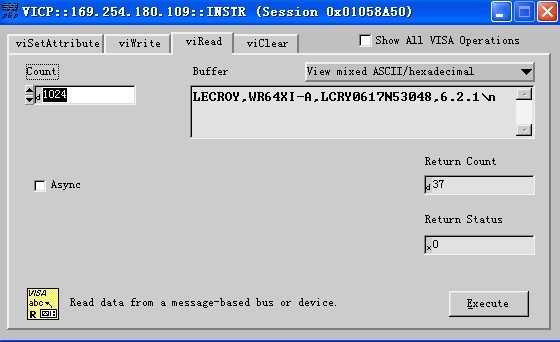

Hello, everyone
I also try to communicate with the waverunner 64Xi by using the TcP/IP. I followed all the steps mentioned in the instruction manual. The test all passed. But the problem is I still can not find the visa source name from the labview programs. It shows visa error for the remote system in the measurement and automation explorer.
Pass the test:
No new source name in the labview program:
Visa error:
I tried this on two computers. Both of them have the same problem. Could anyone give me some suggestions? Thanks in advanced.

Hello Zenguang,
The resource will not show up in LabVIEW.  I am still investigating the MAX VISA error.
However, MAX indicates an error on my PC also.  If you type VICP:: followed by the IP address of the scope in the VISA Resource control, the driver will make the connection.  I actually deleted the item from MAX and I still can communicate with my WaveRunner scope.
I did notice that the first time I begin to type the resource, LabVIEW seems to hang as it scans for resources but it does begin responding again after the scan and I can finish typing in the resource.
