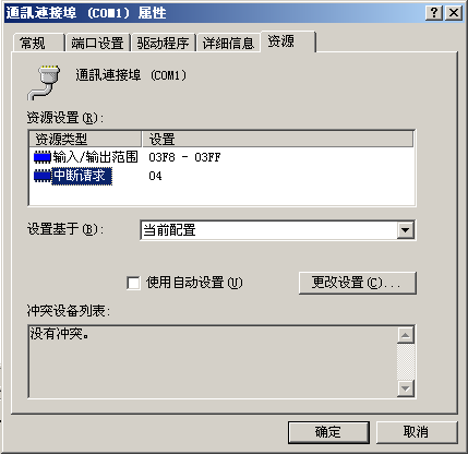

1. How about your OS's version, is it a professional version or modified version? Mybe you need take care of your Operating System;
2. Please open your COM port's property dialog and check if the default value was change? this issue maybe happen on a modified OS.

Hi ghlaah,
It is an unmodified, professional version.  I checked the COM port's property dialog and the default value has not been changed.
