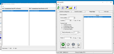

I have a temperature controoler Ascon KX03 that can communicate trhough a serial port with Modbus protocol (I attached the datasheet, in particular at pag. 9 there is an example of the commands to get some information). As first step I connected the controller using a SerialTec software that works fine, so I am able to establish a communication and get, as instance, the current temperature value. I attach the screenshot with the string that SerialTec is sending to receive the temperature value. I would like to read using Labview, but I am trying without success. I attach my simple IV that is not giving any results. Actually, I don't know how to send a string of command (byte and words) to the controller. Sorry if it is a stupid question: how can I send the string of command to the controller to receive and answer and record the answer, please?

thank you very much for your quick answer. I see you are expert on this topic... I am using a software called SerialTEC
ftp://atftp.ascontecnologic.com/Serialtec/ST_101.zip
that has a good user interface and, once I set the right boundrate, parity etc with the address of the controller (1) and the command for reading (200), it gives me the answer from the controller.

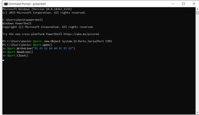

I am trying using cmd, by sending the string 01 03 02 00 00 01 85 B2 (that I read from the SerialTEC software) but, unfortunately, I don't get yet any answer (below the commands that I used..). I will keep trying...
If you have any other ideas, please let me know.
