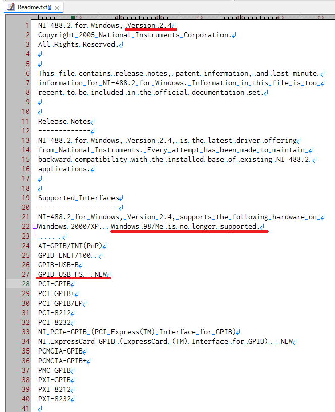

I checked my old NI488.2 and the version that first supported GPIB-USB-HS was 2.4.
However, according to the Readme, 2.4 does not support Windows98.
Therefore, Windows2000 or later is required to use GPIB-USB-HS.

I used version 2.2 and it worked for me!
Thank you so much for your time!
