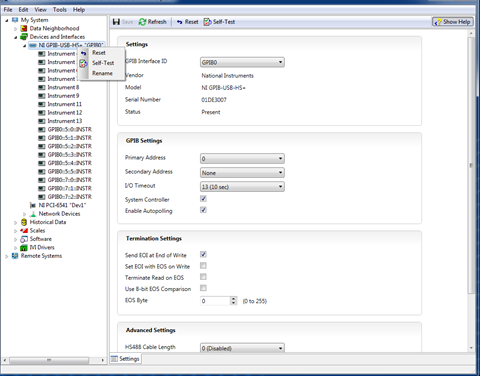

I am having problems getting MAX to recognize instruments.
It only sees two power supplies

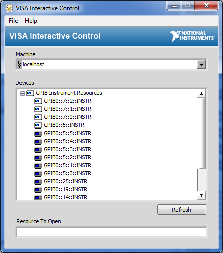

However, The VISA interactive control Sees all of the instruments.

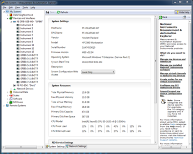

I don't know if this has anything to do with it, but some of the articles I read said to use the 488.2 utility in the tools menu. This is not showing up in the menu.
Another article suggested checking the properties of the USB-GPIB-HS properties. That option also is not available.
