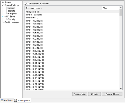

I am still quite new to the labview community but was running into some issues within NI MAX. I am using a Agilent 82357B USB-GPIB connector to communicate with my different instruments. Usually the communication works just fine. The issue I am running into is NI MAX is showing me connections that aren't currently connected. The screenshot below is with no devices connected.
 This can cause NI MAX to time out when opening along with causing it to be very slow. Is there any way to remove these items? I have tried looking on some other threads, using Tools -> reset configuration data, repairing NI-Max using the NI Package Manager, uninstalling NI-MAX and reinstalling it with a new VISA driver install. I am running NI-MAX as Administrator. As a side note I did have to turn on NiVisaTulip.dll. Running NI-Visa 20.0, any help would be appreciated

I tried removing the Alias but there there were none to be cleared. All items still show up on the resource list.

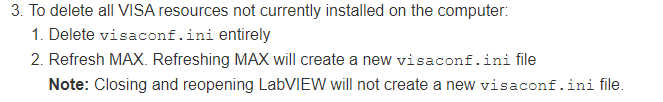

Have you also tried deleting visaconf.ini ? The steps are also in the link.
If you haven't delete it, maybe you can share the visaconf.ini before and after delete so that I can have a look into it.
