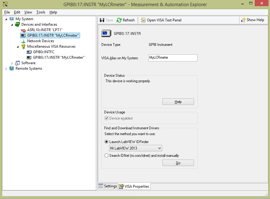

I followed the directions on this page, and I'm pretty confident I can communicate with my LCR meter, because I can go to NI MAX->GPIB0::17::INSTR under "devices and interfaces", then go to the VISA test panel, go to the I/O tab, and I can enter a few commands from the SR720 manual, like changing the frequency, and I see the light on the LCR meter change to what I just told it to do. Here is a picture, just to illustrate it:
Also, if I do the *IDN? command, it returns "
9: Write Operation (*IDN?)
Return Count: 5 bytes
10: Read Operation
Return Count: 41 bytes
StanfordResearchSystems,SR720,08087,1.03\n
 So, that's good too. I also made the alias of this device "MyLCRmeter", but that shouldn't matter for now.

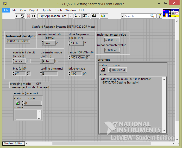

Now I'm trying to get it to work in a more usable way. The SR7xx drivers that LabView found for me came with a couple sample programs, one called "Getting Started.vi". I tried to just simply see if it worked, changing the "instrument descriptor" field to "GPIB0::17::INSTR", since that's the one that seemed to be the right device in MAX. Here is a picture of the front panel of "Getting Started.vi":
Trying to run it like this gave me this error (code -1073807343):
Old VISA Open in SR715/720  Initialize.vi->SR715/720 Getting Started.vi

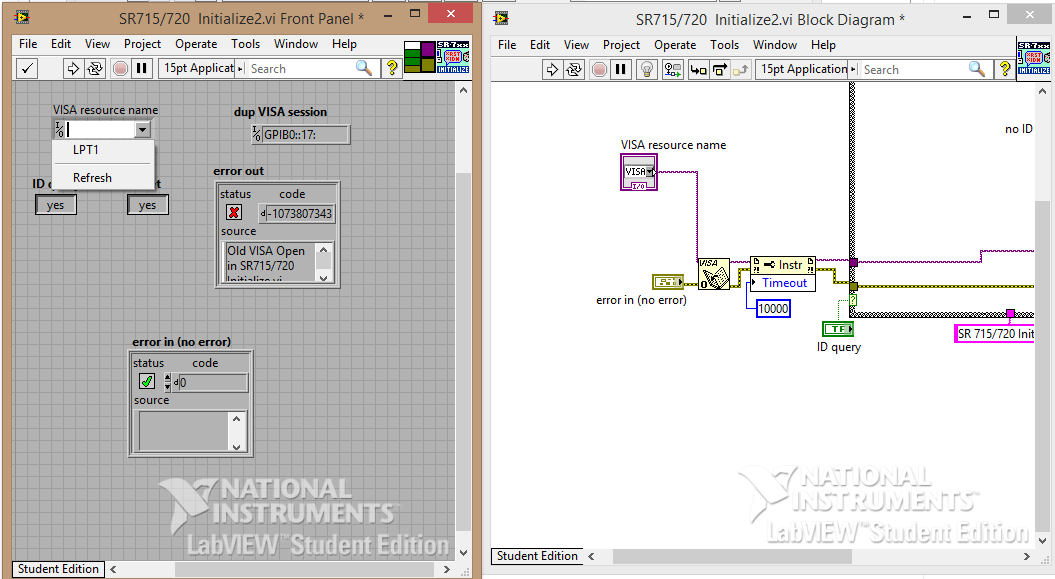

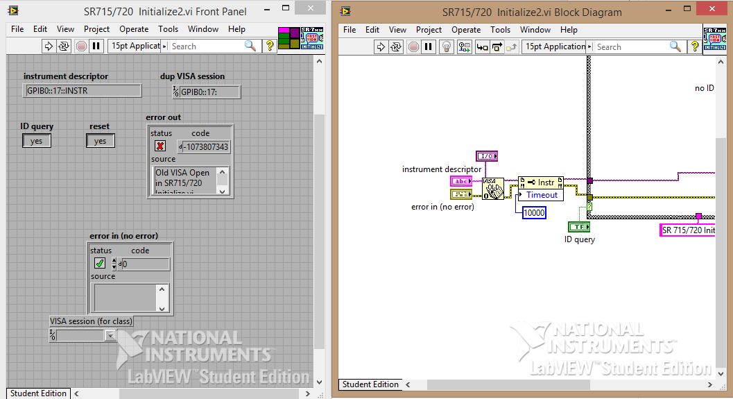

So, I went into the sub-VI Initialize.vi, and did that. Here is a picture of what the front panel and block diagram of the sub-VI Initialize2.vi (I changed the name in case I screwed things up, but I'm pretty sure the new one is the one being called by Getting Started.vi) looked like before I changed anything (you can see the Old VISA Open):
and here it is after replacing that with the regular VISA Open, deleting the instrument descriptor string and replacing it with a VISA resource, and connecting that to the VISA Open:
However, as you can see in the image above, and it seems like someone else had this problem in the 2nd thread linked above, I don't see my device listed in the drop-down menu (even if I refresh), only "LPT1" (I don't even know what that is):
No, I wasnt able to select the visa resource from the pull down menu. somehow it seems disabled or something.
 If I just enter the VISA resource name from MAX manually, GPIB0::17::INSTR, and save and try running that, I get the error(code -1073807346):
VISA Open in SR715/720  Initialize2.vi->SR715/720 Getting Started.vi

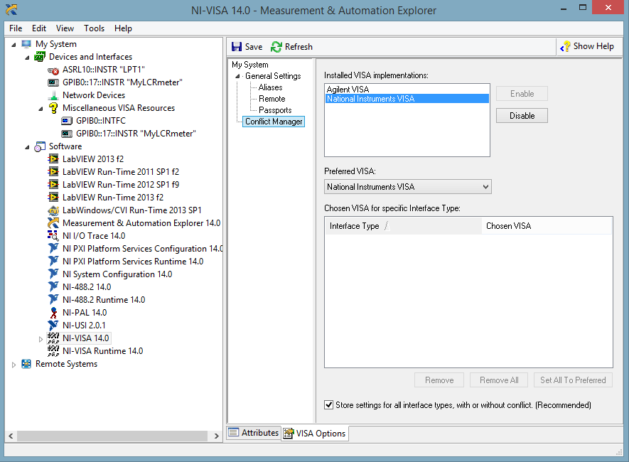

So I'm not sure where to go from there, or why it's not in the drop down menu to begin with. I'm sorry if I've missed something but I've searched about as far as I can go. If I had to guess, maybe one thing could be that in MAX, under Tools->NI-VISA->VISA Options->My System->Conflict manager, I have both Agilent VISA and NI VISA enabled; I know sometimes problems arise from conflicts between different software fighting over the same hardware. Is this okay, or do I need to change it?

When you are not using an NI GPIB controller, you have to enable tulip support in the VISA properties page in MAX. Did you do that? Which VISA did you install as primary? NI-VISA should be.

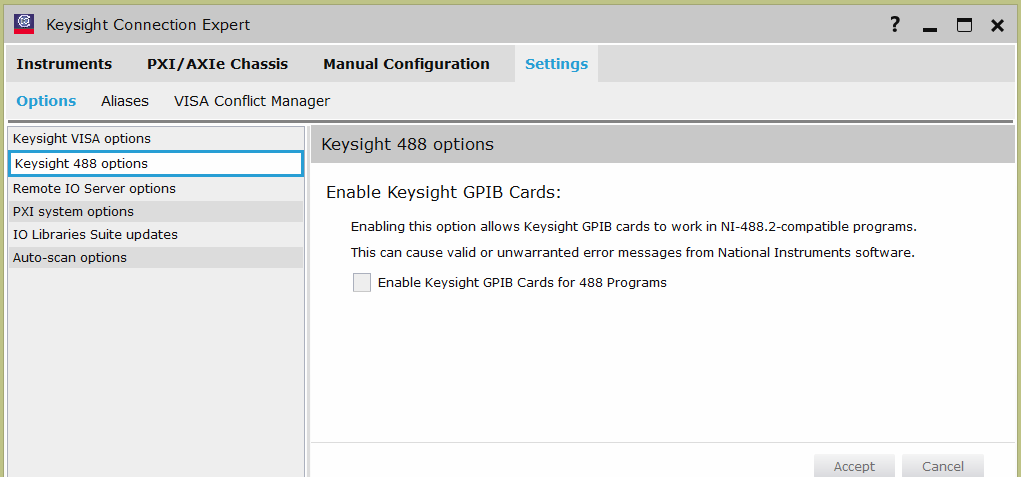

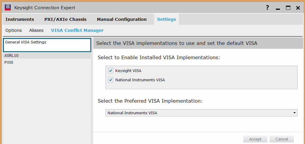

Or somewhere else? I installed NI-VISA first I believe, and then the Agilent one, and during the installation of the Agilent one, I'm pretty sure I made it not the primary. Here's what I have in the Agilent (it's called Keysight now) Connection Expert software:
I also have this under the "Keysight 488 options" tab:
Should that be checked? I don't actually know the role of VISA vs 488 here...

I'm referring to the last step of tip 1 here: http://cp.literature.agilent.com/litweb/pdf/5990-3731EN.pdf?cmpid=1273
However, when I try it in Keysight Connection Expert, it's not letting me select that...

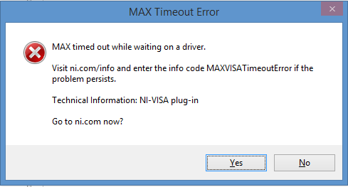

Alright, so this is a little confusing. I restarted my PC (when it "wouldn't let me" before as I mentioned, it said to close NI-configuration manager, then restart my PC), and went to Keysight Connection Manager (KCM), selected that, and saved it, and it worked.
However, now when I go to MAX, when it tries to search for my devices, it gives me this error:
And brings me to this link: http://digital.ni.com/public.nsf/allkb/D57A25E7B74F31E8862577A7005426D7?OpenDocument&metc=MAXVISATim...
Closing MAX and then undoing the option in KCM that I just mentioned, and starting MAX again, I still get the same error.
Anyone have any ideas?
