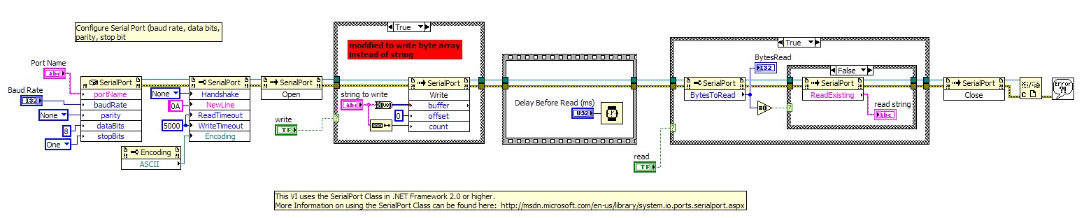

I am unable to get it comunicate at all using VISA.  I am able to comunicate with it now using .NET modified from here:
https://decibel.ni.com/content/docs/DOC-8092
with a baud rate at 4800.  However, it seems to be not reliable at all with characters outside the keyboard character range of 0x20 to 0x7E.

I haven't done anything to the RTS within VISA.  I am able now to get it fully working using .NET with the write BYTES method instead of the write CHAR method as shown in the example linked previously.

I was unable to get the APC220-43 to work properly using the LabVIEW VISA tools.  Using the .NET method works well using the write byte method as shown

After finding the actual code I used I noticed I added a few more things in the configuration.  I'm not sure if all the changes were necessary but I do remember that the handshaking needs to be set to NONE instead of RequestToSend as set as default in the above example.
