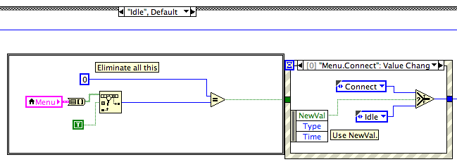

Bhal Tulpule,
USB to RS-232 adapters have a notorious history of strange behavior.  Some brands work better than others. There may be settings within the OS which can help. Although likely not the issue in your case, the power settings which allow the OS to shutdown power to the USB port after an idel period causes many problems.
Your VI still has some problems.  In the Idle state you must press Connect twice to change to the Connect state.  Turn on Execution Highlighting (the lightbulb on the block diagram toolbar) and run the VI.  Wait until the little dots stop moving on the block diagram then press Connect.  You will see that the value fed to the Select inside the event structure is the value which was present on Menu when the program started running, not the changed value.
Similarly, the Serial Port selector will use the value which was present at the time the VI starts running, not the value to which it may be changed later.
Read the Help files for Event Structures. It is highly recommended that only one event structure be used in a program.  Alsoe things like opening a file, which may take some time, should generally not be inside an event structure.  Look at the Consumer/Producer Design Patterns for an alternative approach.
The sequence structures in Make_Next_Pkt_Rev2.vi do nothing. That VI will produce exactly the same results without them.  Generally it is better to avoid sequence structures.  They are rarely needed in well-written LV programs.
Lynn
