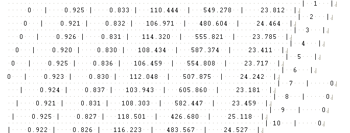

One question: do you think LabVIEW is adding the CR/LF?  The reason that I ask is that the CR/LF is really there, it is not just an issue of the program truncating the lines early.
Here is a picture of the data shown with the special characters:
"There is a God shaped vacuum in the heart of every man which cannot be filled by any created thing, but only by God, the Creator, made known through Jesus." - Blaise Pascal

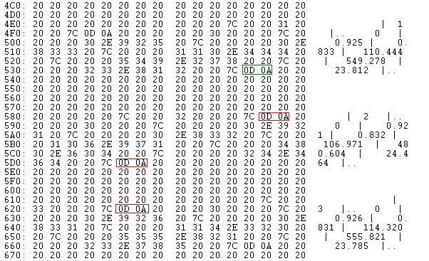

Here is the data in hex:

The fact that hyperterminal is giving the same results points the finger at the host machine.  It looks like the host is trying to transmit a reading # and then 6 values?
One thing I noticed is that the host does not transmit a consistant # of 0x02 between the sets of readings.  71 and then 70 and then 69 etc.  I really think there is mistake in the host program.
Can you post a text file containing the hex data?  I'd like to try something.
