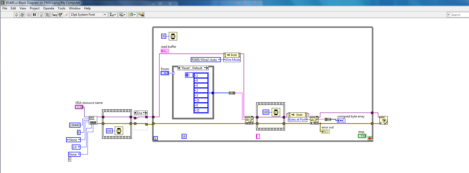

2. This is my sample code. Very basic, sometimes I abort it as a part of development.

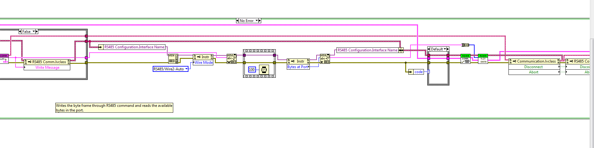

3. This is from my main application where I use Objects, Parent Class is Communication, Child 1 is CAN & Child 2 is RS485.
FYI, I just found that the reference out of "VISA read" not bundled back to the object references (I corrected the code as shown above). But I close the reference in of "VISA Flush" when the task is completed.
Will this be causing me the problem?

Hi @grimmy123,
Thank you for adding those screenshots. I do not see any red flags in your code at first glance that could be causing what you are seeing. But just so that we are both on the same page, are you saying that from what you understand, aborting your program in LabVIEW is causing your NI-RS485 device to dissappear in MAX? I am going to try to replicate what you are seeing on my end and want to make sure I am trying trying to replicate the same behavior you are seeing.

Good Afternoon @grimmy123,
http://www.ni.com/documentation/en/labview-comms/2.0/debug/abort-execution/
With reference to the document above: "Aborting a program that uses external resources, such as external hardware or file I/O operations, might leave the resources in an unknown state and cause the program to return errors the next time you access the resources. An alternative to using the Abort button is to enclose code that uses external resources in a While Loop with a Stop button. Using the Stop button instead of the Abort button cleans up external resources before stopping execution."
I recommend that you do not press the abort button to exit your program. It can cause unexpected behavior such as the behavior you are seeing. It seems like you have found a good work around. I cannot say one way or the other whether it will cause the device to unregister its port completely. I tried replicating this issue and the device did not unregister its port completely. However, that does not guarantee that this is what will occur for you as leaving resources in an unknown state by pressing the abort button results in unpredictable behavior. I would recommend not using the abort button and implementing a stop button in your code that will close out the reference as it appears you already have in screenshot number 2.
