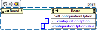

From here you can right click on the reference output of the Board Constructor Node and navigate to and select Create»Method for National Instruments.NI4882 Board Class»SetConfigurationOption as shown in the attached code snippet.
I Hope this helps, if you have any other queries, let me know.
