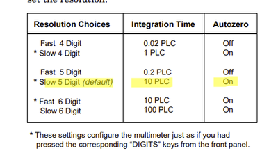

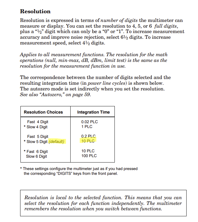

You would have read the manual for 3 hours but still missed this highlighted part in pg.55 of the manual.
Resolution setting of the DMM determines the time it takes to measure the signal and directly translates to the resolution. In your python code, you did not configure the resolution and hence default setting is 10 PLC. PLC means Power Line Cycles, 1 PLC is the time taken by a single cycle of your mains AC supply, based on your region, it will be 20ms (50Hz) and 16.67ms (60Hz). 10PLC translates to 167 ~ 200ms of measurement time.

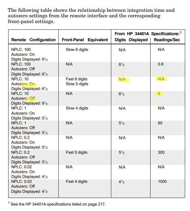

Another thing to look for is Auto Zero, this precedes the measurement phase and also adds time. The default setting is AutoZero ON.
Manual does not provide a specific readings per second for the default configuration with AutoZero ON but with OFF, the best it can do is only 6 per second.
With 343ms per reading, I think, almost 3 readings per second is still acceptable because you did not optimize your settings for speed, you just took the default settings and started automating using python.

Thank you for the thorough response! It was definitely the resolution slowing me down. I'll paste my updated code below to anyone who ran into the same roadblock. The command I added to decrease sample time is  'CONF:VOLT:DC 10,0.001', which sets the dmm to dc voltage reading in the 10V range with 4.5 digit resolution. My sample rate is now 7ms.
