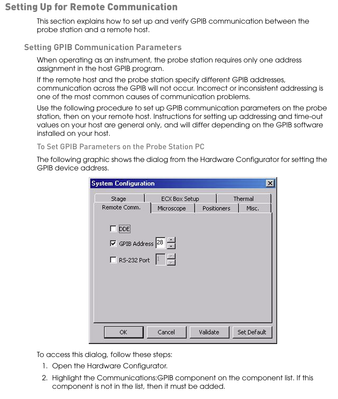

I have enabled GPIB communication from the hardware configuration window in Nucleus, following the instructions provided in their communication guidelines. Is this what you meant by changing the settings of Nucleus, or is there another setting I have to alter?
(308 Views)
Yes, that looks like the right setting to put the prober into the listener state.  Did it work?  Confirm using NI-MAX.   Do you see your USB-GPIB-HS interface?  Do you see an instrument listed under that at address 28?  (This part has to work before bothering with any code!)  If you do see an instrument listed at something like GPIB1::28::INSTR,  then try to communicated with it using the "Communicate with Instrument".  Once the prober is responding to "*IDN?" then you can try communicating with it through code.
