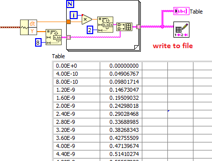

Here's one simple way to generate your time column for the data part. Simple math!
Writing the header (fist N lines) is up to you. 😄
To get the 2.63e-5 offset (t0), add that after the multiplications. Is it meaningful?

Thank you ! I'll test soon.
 I think it is meaningful because this information is important about my research.
