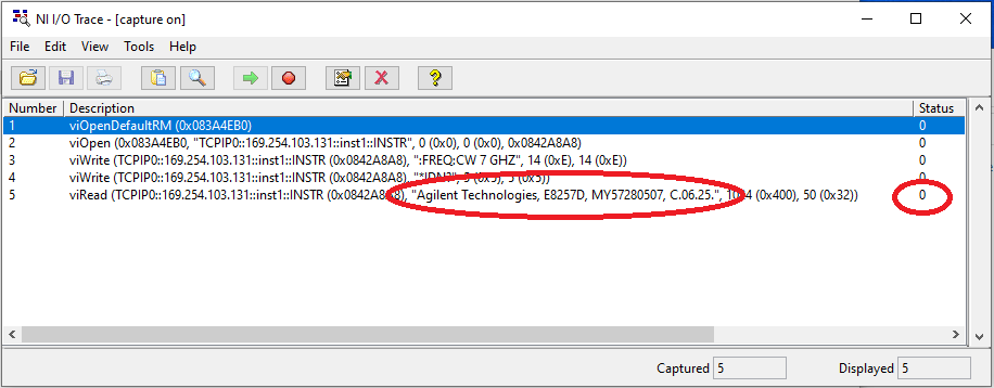

Thank you,
This helped me to investigate !
Here are the traces :
It can be noticed that the program exited the function with status 0 (ok) and returned the good value ("Agilent..."  ).
After some research, i found that the issue is at the function declaration level.
Actually, the viRead DLL function expects to receive a pointer. As String values are passed by Reference in VB6, the declaration of the buffer has to use ByVal keyword.
To summurise, for passing String pointer to the buffer :

For now I gess the program crashed due to memory corruption using ByRef instead of ByVal
