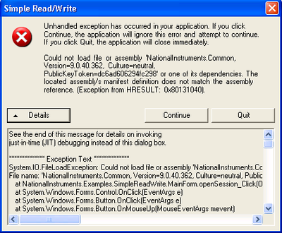

 I than went to do what it said and add the NationalInstruments.Common reference but I can't find the version it says.  The closest version I found is 9.0.40.159.  I added that version and it works just fine on my Windows 7 machine but when I run it on my windows XP machine where my equipment is, it has the following error:
Where would I find the correct version of NationalInstruments.Common?  Or how would I fix this issue?

I did what you suggested and installed the NI-488.2 drivers (Version 3.0).  I went and rebuilt the SimpleReadWrite project but it still had the same NationalInstrument.Common version error.  I looked through the references I could add in VS2010 and I did not find NationalInstrument.Common version 9.0.40.362.  I was hoping by installing the NI-488.2 drivers that it would install the missing version.
I did find a way around the issue yesterday.  I created a app.config file to remap the missing version to the version I had and it seems to run now, I need to test it more.  This is what I added:

Is there a better way to fix this issue?  Or should I just go with the app.config workaround?
