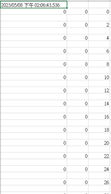

Hi
After the test, the file format is as shown below.There is no occurrence of different data at the same time.
The file below is my test file.
