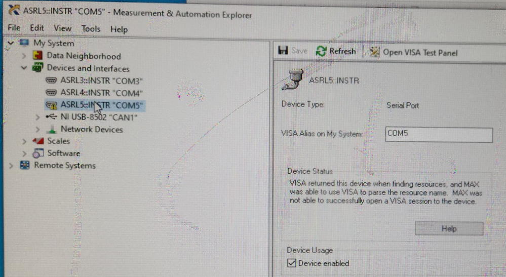

I  changed the Windows advanced power settings to disable USB Selective Suspend Setting, but a week later the COM port problem returned. After exiting the program, in NI-MAX I found the following below. After pressing F5 to refresh, the Device Status returned to normal and I was able to run the program without issue. I still don't know the reason for this, are there any ideas? Is there a way to detect and recover from this programmatically?MaxScn.pngMaxScn.png

Thanks for the tips.  I wish I had a choice of hardware, but unfortunately our external device (Eaton CCT01 Contamination Monitor) is USB based, so there is no converter to swap out. I'll check the Windows 10 version number - Hopefully, if there is a known compatibility issue with the driver, SiLabs will be able to correct it in the next release.
