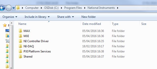

I have downloaded numerous third party drivers and saved them locally on my C:\.
Where should I move these .lib files so that I can use them throught he functions Palette?
Is there a certain structure I should use when saving these?
Also what is the difference between user.lib & instr.lib files?
I have tried to find the folder as outlined in the following tread but I cannot seem to find the folder:
How Do I Install My Third Party Instrument Drivers?
This is what is at the recommended loaction:
Can anyone help?

instr.lib is for instrument drivers.  user.lib is for your own private libraries.
I am guessing you are on a 64 bit OS.  So you should be looking in C:\Program Files(x86)\National Instruments\LabVIEW (20XX)\instr.lib

Thanks crossrulz this worked.
I knew it had to be somehting simple.
