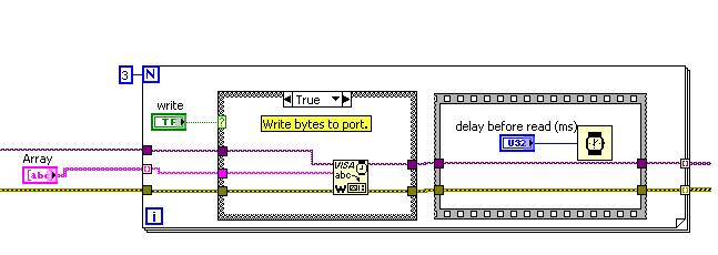

Hi Scott,
Thank you for your reply. I am a novice learing Labview. I have spent a few hours learing how to make arrays but need some adivce to put it all together.
Can you please have a look at the attached file and offer some advice.

Hi Mark,
The for loop needed to be around the serial write command, and the "-" character in your strings was "subtracting" the rest of the string. You can delete the "read" section from the code if your not going to be using it. Have a look at this see if it gets you going in the right direction.

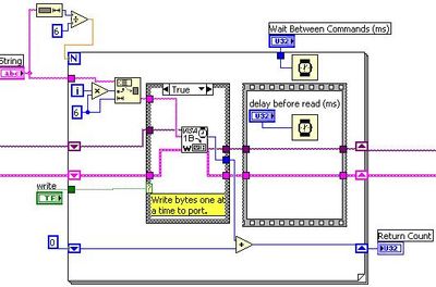

I got it to work without using an array.  Since I know the number of characters in each command (6), I was able to have it sending only 6 characters at a time from a string composed of many commands typed one after the other.  I put in an option for the user to control how much time elapses between each command sent.  Keep in mind I started out using the serial-write-and-read-1-byte.vi that is available on this site, so it looks different than the ones above.  However, the elements and wiring I used to carry out this task would also work for the programs above.
Here is my diagram:
Message 9 of 13
(9,520 Views)
Well, it seems a bit Rube Goldbergish. And your wait in between commands is not quite correct. It executes in parallel to your loop so it does specify the wait after the write. You could add a sequence structure to the write case or simply use the Delay function and wire the error clusters - think dataflow.
