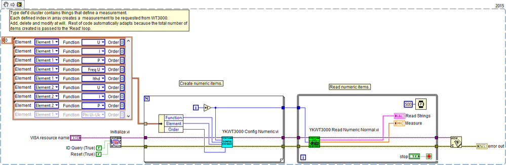

Let me start off by saying I am a novice with LabView.
I am using both the WT3000 in a test setup to measure specific input/output characteristics of a EUT. I am attempting automate this step by using Labview, with the 3000 connected via GPIB (NIMAx) to my computer.
I have written the program below for the Yokos to first make the following measurements using Elements and 2 to measure input & output of the EUT:
Element 1:
  • Input Voltage (U)
  • Input Current (I)
  • Input Power (P)
  • Input Freq (FU)
  • Input Harmonics Distortion (ITHD)
Element2:
  • Output Voltage (U)
  • Output Current (I)
  • Output Power (P)
Then in the last frame get all values from WT3000 and display.
When I run my program below I get readings just for my Input voltage and Current on Element #1
Not sure where I am going wrong…
Step1
Command for measurements on Element#1 per above:
Step 2
Command for measurements on Element#2 per above:
Step 3
Query all measurements made on Element#1 & Element#2:
Any help would be greatly appreciated.
Thank You

Shakes84 - I suggest that you download the free library for the WT3000 from here.  http://sine.ni.com/apps/utf8/niid_web_display.download_page?p_id_guid=F1AD0986274A22AFE0340003BA230E...
What version of LV are you using?
(2,708 Views)
I don't have a WT3000 here but I have several 500s and 1800s which have the same basic command structure.  This should work if you download the WT3000 library from the Instrument Driver NetworkWT3000%20Example
(2,696 Views)
