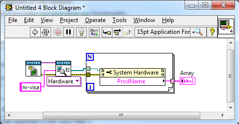

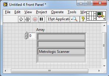

you can use the MAX API in LabVIEW.
Example: I have an USB handscanner from metrologic. The device description in the INF file is "Metrologic Scanner".
Hope this helps!
