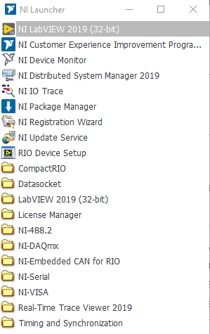

I'm wanting to start looking into using some NI equipment and LabVIEW in an R&D/Product Development environment.  I've acquired a cRIO-9081 that we used to have that was never used due to the engineer on the project leaving the company.  I'm having issues understanding how I can have the cRIO connect and talk with my laptop so I can see the cards that are plugged into the cRIO.  The cards that I have are NI 9219, NI 9375, NI 9205, and NI 9214.  Software side, I've downloaded the 7-day trial of LabVIEW, I've got RT Trace Viewer, RIO Device Setup, GPIB Interactive Control, NI Device Monitor, NI Launcher, and others (see picture).

Hi, brethigh
Here is the all software that will need you to work with cRIO-9081:
1. LabVIEW 2011 or later
2. LabVIEW Real-Time Module 2011 or later1
3. LabVIEW FPGA Module 2011 or later2
4. NI CompactRIO Device Drivers 4.0 or later
for the modules you are using, you will need also install NI-DAQmx (same version in compare all above software versions).
